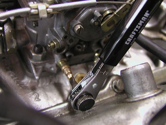

With the basic installation completed, it's time for the sometimes laborious process of setting up and tuning the carburetor. Step 1 is to set the idle screws. They're buried down in the V of the engine, so I had to buy this little right-angle screwdriver to turn them.
