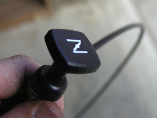

I started out with a generic "Help" brand cable from Autozone. But later, when I was ordering some other parts from Pierce Manifolds, I splurged and spent $10 on a 49-inch "official" choke cable. Not only does it have a choke symbol on it, it's limper than the generic cable (making it easier to thread into the engine compartment) and it operates more smoothly as well. TIP: Pierce sells two other choke cables besides the 49-incher -- one shorter and one longer. DON'T order the shorter one! The 49-inch cable was just barely long enough, and the shorter one (I think it's 36 inches) would have been much too short!
