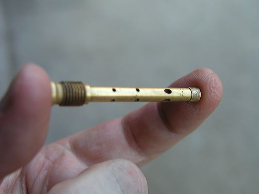

Another thing that can be fine-tuned on a Weber carburetor is the jetting. This picture shows one of the main jet assemblies (there are two in a DCNF, one for each barrel.) The threaded piece at the thumb end is the air corrector; the holey piece in the middle is the emulsion tube; and the small cap at the far end is the main jet. The MSS kit comes with jets chosen to get you up and running, but if you want to fine-tune them -- as I did -- they're conveniently easy to change.
