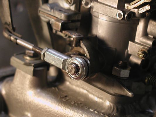

The linkage rod itself is a nice piece with a spherical bearing at one end, a sturdy spring clip at the other, and a provision in the middle for adjusting the rod's overall length. You need to make sure the rod is adjusted so the throttle opens and closes fully when the accelerator pedal moves through its range.
