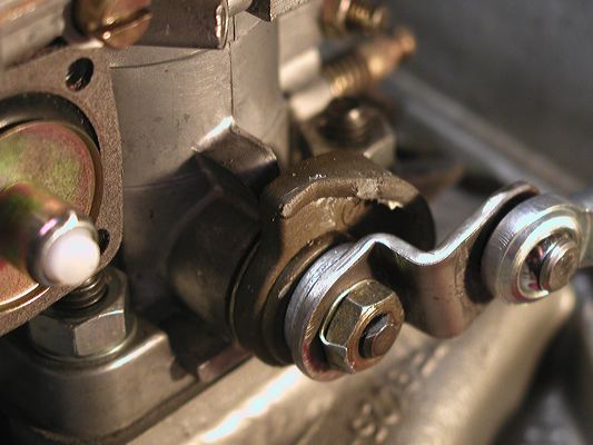

This circular cam around the throttle arm operates the accelerator pump. I've removed the pump arm here so the cam is more visible. I thought the cam was making the throttle action a bit stiff, so I smeared a little white lithium grease on this cam.
