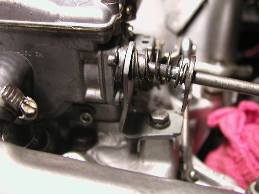

The "foot" that supports the throttle rod bolts onto the manifold. The spacing is tight here, so the support foot furnished by MSS is bent slightly to clear the accelerator pump housing on the end of the carburetor. Mine still touched the carb, so I added a bit more bend.
