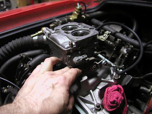

The mounting nut for the rear driver's side stud is REALLY hard to attach! There's not enough clearance under the carburetor to install the nut once the carb is pushed all the way down. So, it's necessary to hold the carburetor partway up, slip in the nut, then slide the carburetor down onto the stud as the nut is tightened.
