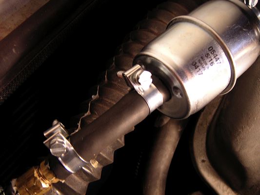

MSS recommends a metal fuel filter. Also, I learned the hard way to use skookum fuel-line clamps (note solid band) to secure the rubber line -- generic worm-drive clamps may not grip firmly enough, and can cut into the hose if you tighten them too much trying to get them to hold.
