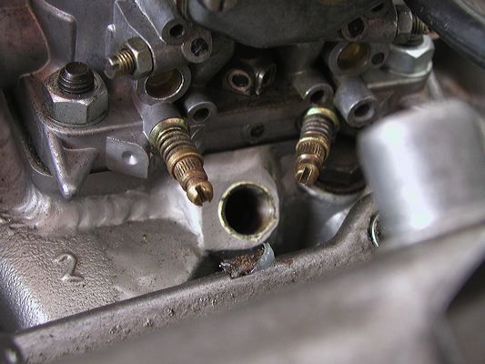

Another problem, one that most people won't have: I have a cruise control installed on my Sonett, and the cruise control unit's servo is powered by engine vacuum. That meant I needed to find a place on the new manifold to connect it. Fortunately, the MSS manifold comes with a capped vacuum fitting, which I believe is intended for hooking up the power brake booster on the model 96. Using a hex key, I unscrewed the cap, revealing this hole into the manifold.
