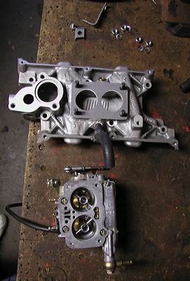

Here's an overhead view with the carburetor and manifold separated. At the top are the new throttle-linkage support arm and its base, along with the mounting nuts and washers for the carb -- all included in the kit. The manifold comes with its PCV valve and hose already installed. The gasket for the carb baseplate (shown in position on the manifold) also is included. At the bottom is the carb, with the vacuum hose for the distributor already attached.
