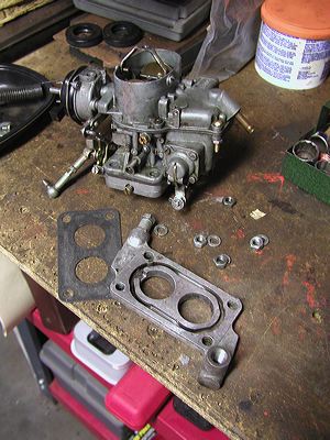

You can't remove the carburetor and manifold together - the carb blocks access to the center manifold bolts. So, off comes the Solex. In the foreground is the intermediate plate that provides the connections for the PCV valve and the power brake booster on the model 96. (The Sonett doesn't have a power brake booster, so I plugged this.)
