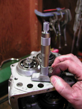

The first step to choosing the shim thickness is to calculate the clearance between the back wall of the gearbox and the rear cover. Here, I'm measuring the shoulder height of the rear wall with a depth micrometer.
